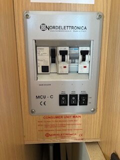

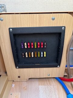

Hi I have an abbey gts 416 2007 model. New caravan owner 👋🏼
We used the caravan first weekend no problems. Second time out the battery doesn’t seem to be charging anymore when caravan is hooked up to mains. We’ve replaced the battery think it was due to age but it just drains when in use. When I’ve been googling I can’t find this model for the fuse diagram can anybody help?
I’ve got a feeling it might be the charger but on other forums it’s suggesting there is a rocker switch. I can’t find one in this van, is there even one?

I do not feel there is enough info for anyone to diagnose your electrical issues. I feel it needs researching by someone with a multimeter and some electrical knowledge. It could be a number of things. But any suggestions would be guesswork.
Reactions: ProfJohnL

The power supply you have had a bad reputation for reliability. If it is faulty there's a company who make much better replacements. It’s been mentioned many times on the forum. It’s Apuljack. See link below. They are always willing to discuss issues.
Jun 18, 2024
10
Yea found that out this afternoon from other posts on the forum. I’ve sent an email too Apuljack. Thanks for your help.
