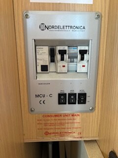

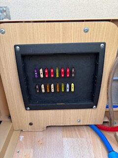

Hi.
I have the abbey gts 416. Does anyone have a fuse diagram for one of these please. Can’t seem to find one anywhere.

If you cannot get one....
Switch everything on, then pull a fuse and see what is no longer working, label that fuse (but don't replace it yet) Continue this until you know what each fuse protects.. Then reinsert all the fuses.
Takes a while, but its a system that works..
