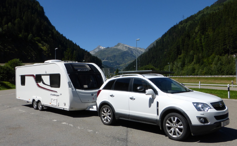

We towed at 96% with this set up with no issues what so ever. Obviously it was a twin axle but people often debate about whether they are inherintly more stable or not. It also had ATC. This is the closest to 100% we have been.
That was taken on an extensive European trip on the way to the Italian Lakes and back via. France and Switzerland. We covered thousands of miles on other trips too.
I don't think from memory we have ever towed at 85% or less since the 80's.
We are currently at 87%.
(Be accurate with weights though an preferably get the 'van weighed accurately too).

Nice outfit. How long had you been towing when the photo was taken. I don't think the OP has much towing experience so that needs to be taken into consideration as I am sure that they do not want the caravan to dictate where they are going?

That was taken in 2016 so around 30 years to take account of the years we didn't have a 'van.
But my main point was to show as a general comment that it's perfectly possible to tow at over 85% which lets be honest is a bit arbitrary anyway. Obviously the 85% figure is much vaunted (mainly by the clubs) as a limit for those new to towing but nobody can ever say what it's based on, other than it's lighter than the tow car.
I honestly couldn't discern much if any difference between towing that and what our setup is now and previously. The current 'van is a single axle with no ATC. With it's weight upgrade it comes in at 87%.
All that said I personally wouldn't go much closer to 100% than 96% and deffo. not over even though I know some do. Logic to me says having a trailer heavier than the car is a recipe for trouble, even though it might be legal in some cases eg towing with some JLR products.

The 85% is only a guideline and well outdated, but in this case they need to be careful that preferably they do not exceed 95% of the car's kerbweight. Which is why I suggested a caravan with MTPLM of 1700kg would be preferable for safe tow. (y) :)
