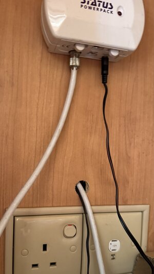

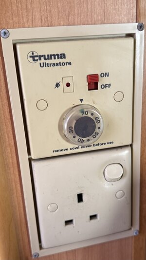

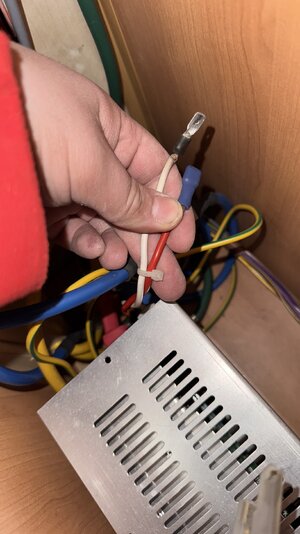

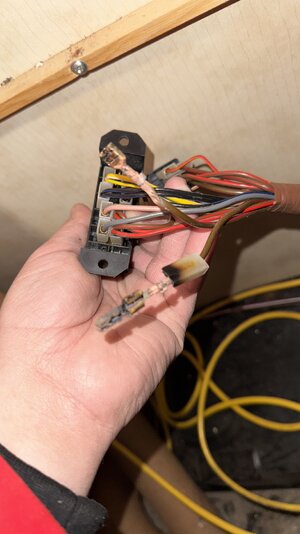

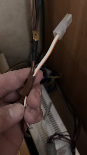

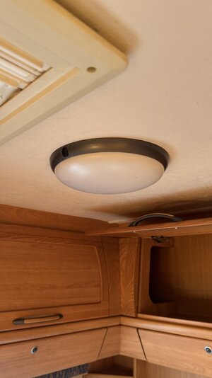

I have bought Ace Award Northstar Caravan 2002 year. And there i found few problems.
1. Some sockets are not working
2. Some interior lights are not working
3. Few cables are burned
4. Some cables are not connected
Pictures are attached. Hope you can help find solutions.

You have quite a task on your hands. With the issues you have described I have to ask do you have any electrical training or experience, because you will need it if you want any chance of resolving the all the disconnections and functions.
You Will need a copy of the caravans wiring diagram, which should identify what wire goes to what by colour code. However that fact you have some burnt out connectors also suggests something has gone faulty to cause these things to over heat. You will need to track down what has gone faulty and either replace/repair or remove it before attempting to use it again. Obviously all the damaged connectors partly bare wires will need trimming if theres enough length or to have quality repairs done to them.
The pictures you have shown of damage all seem to be on 12Vdc equipement. wiring. Even though 12Vdc is very unlikely to give you a shock, there isenough current capability in the caravan battery to cause wire to overheat and possibly set fire. So do not skimp on the 12V wiring repairs.
If your in any doubt about whats what, it will be far quicker and safer to call in a caravan Tech who should be able to work through the wiring and test it appropriately.
