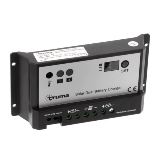

If the solar panel controller is a Truma it is quite simple to switch it to AGM. We have an AGM battery in our caravan.
Reactions: CrewOVtwo
Oct 19, 2023
574
461
1,135
Hope this helps.
Looks like a Truma SDC 10. Link to operating manual below which says that it has a setting for AGM batteries.
Reactions: JTQ and Buckman

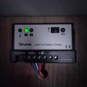

Thank you gents. Have found the manual and it told me how to change the settings to AGM.
The solar charger is a SDC 10/20 and using the 'SET' button I was able to access a scrolling menu of numbers to the '2' which corresponds with AGM.
