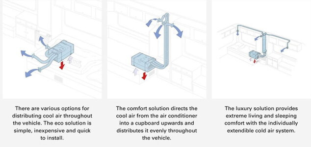

I have never had aircon in a van. So I cannot properly advise. But I always fancied the underbed ducted system. Looks very neat and can be directed to different parts of the van. I did fancy fitting one myself. Looked like a nice project.
16,925
5,505
In a previous caravan we did look at fitting the under bed one, but firstly weight displa cement was an issue as nowhere over axles to fit it. Secondly if you have ALDE heating ducting is required. Lastly and more annoying, because it is mounted on the floor the noise and vibration seems to penetrate every corner of the caravan.
The other thing about under bed is the theory that cold air does not rise so your feet may be cold while your forehead is sweating. With the overhead air con, the cold air drops down through the warmer air overall cooling the air a lot quicker.
5,896
2,803
I take your point that it may be noisier and is something to research.
But I had a plan for my Lunaar to duct through the wardrobe so the outlets would have been at a high level. This would not have interfered with the Alde heating. The unit would have been just to the rear of the axle.

There are pros and cons to both types, some of which have already been mentioned. The issue of cold air not rising is usually overcome by ducting the chilled air to head height before letting it out, but the ducting does take up space,
But on a positive note the ducting can also ensure the chilled air can be directed to other parts of the caravan, where as the roof mounted unit usually sits in the main saloon, and won't chill other spaces. Both roof and floor mounted units have direct mechanical connection with the carcase of the caravan, and will couple some noise to the structure. Careful placement may reduce these effects to some extent.
The other factor often not fully understood is how effective (or ineffective) these units can be, so its important to manage expectations. If your expecting chilling performance like you get in your car - Forget it, it wont happen to anything like the same extent. AC units in cars can typically consume about 7 to 8kW of mechanical energy from the engine. The maximum power available in a caravan for AC is typically up to 2kW, or roughly a quarter of the input energy, consequently a caravan unit is only ever likely to provide about a quarter of the chilling effect of that found in a car, coupled to that the volume of a caravan is several times larger than a cars cabin, so that will further reduce the overall effectiveness of the AC. Just don't expect the bone chilling car experience in a caravan.
That then begs the question is AC in a caravan a really a cost effective solution? That is a personal decision, but it's worth thinking about the loss of payload, weight distribution (from a towing stability perspective) how often will you need it, If its only a few times, is it worth the cost? If you need it at night, then the system needs to located in the right place, and quiet enough not to disturb you. Could yo actually be comfortable enough with a couple of decent fans at a fraction of the cost?

We have a Truma Saphir Comfort RC under bed/bunk A/C. It is very efficient at cooling the caravan and the noise inside is acceptable - it doesn't disturb us at night. However, a word of caution. If you were think of fitting one, when the compressor cuts in, it is noisy outside. Consequently, because of disturbing our neighbours, we use it very infrequently.
Why have an a/c at all? We tend to drift all over Europe. In some places, it can be very hot and an a/c is a blessing. Also when the family come and join us, 4 adults in a small van create a lot of heat.
Why an under bed/bunk one? We didn't ask for it but specified an a/c when ordering our caravan in 2006 - I was working in Germany at the time. When the caravan arrived, it was clear that there was not room for a roof fitted one. Being none the wiser, we accepted the under bed/bunk one.
We replaced it in 2018 for a new one hoping that it would be quieter - but the outside noise reduction was marginal.
Accordingly, if I had a choice, I would avoid an under bed/bunk one and go for a roof fitted one. We had a Truma roof fitted one on our previous caravan and it was quiet and efficient.
