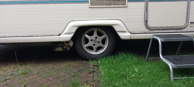

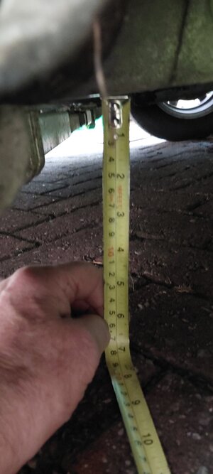

I have an Avondale Dart 2002 and I think that the suspension is a little low, as my ride height (Chassis just in front of the axle to ground) is around 7 inches as in the photo.
Also the wheel looks to be too high into the wheel well.
What are the thoughts of the masses.
Thanks
Suspensions have been known to collapse. But it would be impossible to judge that from pictures alone. Technical evidence would be needed. Possibly Alko (if it is an Alko chassis). Might be able to provide the laden angle of the swing axle.

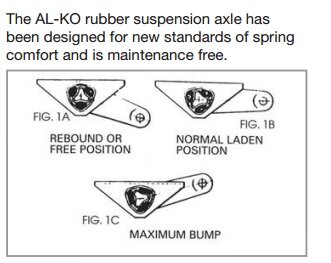

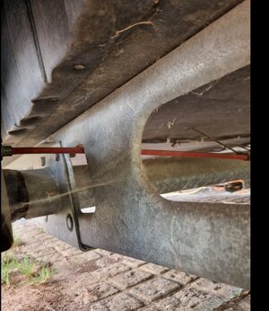

Interesting info on the euro axles, Aluminium alloy does corrode particularly if connected to steel components unless coated or anodised, Alko trailers are full galvanised to stop corrosion. To check the axle look at the first image . The axle should be in position 1B when stationary. Also there should be about 25mm clearance above the wheel to the wheel box. Another giveaway is the brake cable touching the top of the hole in the chassis - see second photo. Make sure you haven't overloaded the caravan , get it weighed at a public weighbridge and check its MRO and MTPLM weights.

The van tows great straight as an arrow up to 60, we were in the south of France in June, it just that it dragged its rear end lightly in the site we were on at the weekend , it was a bit rough! Other than that it's good. The motor mover has only 4 3/4 of an inch clearance

You will, most axle s have some rubber sticking out .The other issue is that someone may have in past fitted bigger tyres to the rims , check the manual to see what tyres it should have . there are quite a few different models of your van , 4/6 berth so you will need the full model number.
