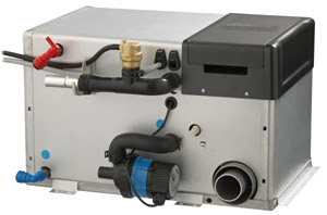

Thanks for that. Any idea where the boiler actually is? I can’t find anything online or in the handbook.
