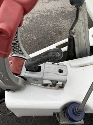

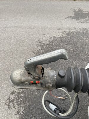

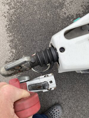

Good afternoon, I have recently bought a used Alko hitch to replace my hitch on my Elddis Avante 2002 . I also bought a kit with new bolts and pins and size guides . But as you can see from the pictures on my old hitch the bolt holes wont line up with the Alko hitch . On the old hitch there is one bolt in the side and one bolt under the rubber bellows that goes down the way . Is there anyway to attach the Alko hitch .

When the Alko stabiliser hitch was first introduced as a accessory/replacement part there were TWO variants, one with the bolts both in the horizontal plane (as on the one you have bought) and one with the bolt holes opposed (as on your caravan). The one you have won't fit unfortunately.
The original type was sold/labelled as an AKS2000.
Thanks for the info

One bolt goes through the end of the damper. This needs pin knocking through to retain the damper in position whilst hitch head is off.
