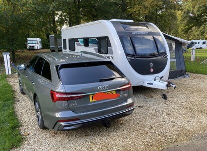

2250kg unladen and 2000kg towing limit, ticks all the boxes legally and the oft-quoted percentage recommendations. There’s lots of others out there as well now:IMG_9499.jpeg
