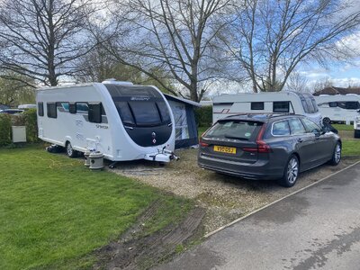

I've always used estate cars for towing, I prefer the lower driving position and they're usually heavier than the saloon versions. Over the years I've had Mondeo, Passat, Mercedes C Class, BMW 5 series and latest 2 x Volvo V90's. Usually better economy than an SUV as well.

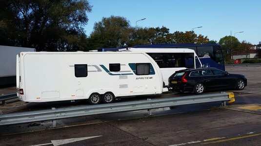

We have had three Passat estates, two at 140bhp and one at 150bhp and they were all superb towing machines on a Bailey Pegasus 462 and no a Unicorn S4 Seville. OK not quite in the same league as the A6 but nonetheless a brilliant motor!

My only other comment is to check the towing limits. My previous Volvo V90 (diesel) had an 1800kg limit whereas my latest petrol version has a 2000kg limit. All well within my own towing needs but it just shows that sometimes there is a noticeable difference in limits between variations of the same model.
One other advantage of an estate is that I can enter multi-story car parks with the roof box on, I couldn't do that if I'd gone for the SUV style XC60/XC90!
