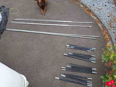

Hi, I managed to figure out the pole situation and put the awning up pretty quickly.
This is what I used:
2350mm pole + 1780mm pole. Tensioners x2. Top of photo
2060 + 550 joined together in photo. Rear upright poles x2. I'm told these are optional extras.
490mmx5 + 590mmx3. Fibre glass x 4
There's also some poles used to prop open the awning door (not pictured).
