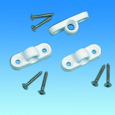

Is this the sort of thing you have to fit?
12,062
4,229
These are instead of the screw into the caravan wall, type if your awning has the bead to clip onto.
https://www.towsure.com/dorema-awning-quick-lock-pad-pack-of-3?gclid=CjwKEAjw__fnBRCNpvH8iqy4xl4SJAC4XERPcB_AnfUhwRB4K6AL7iSlbET_s1Nf1pczbz1XU-F0whoCWtLw_wcB#group
Jan 19, 2002
1,688
532
Shows how much things change! My first caravan and awning required the screw-in brackets which was common usage until I think Isabella introduced the fix-ons ?in the late 90s with the second bead on the edge of the awning to slide them into place. So front and back the brackets sat more or less horizontal and along the side wall vertical set against the edge of the awning rail. Sat on a gommet of clear or white silicone as well as being screwed. You can still buy these https://www.ebay.co.uk/i/173723130921 - or search 'awning pole suckers' on the same site as alternatives.
