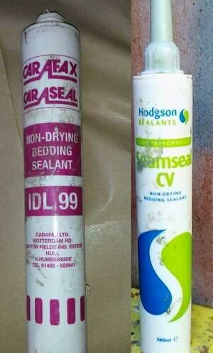

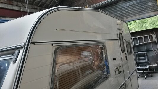

I use the bitumastic sealant as in the images I've posted..it allows for the expansion and contraction experienced of the aluminium..it is made in Hull near where there was a considerable amount of caravan manufacturers at the time..my images have details on I removed the rails ...you might find them of interest...My caravan is a 1992 Abbey GTS 212

I assume all the surfaces are spotless and all traces of old adhesive removed ?
Personally I have only used Soudal RV61 as used by the professional caravan repairers.IMG_6198.jpeg

Note the sealant images I posted are for aluminium rails..is the soudal a flexible sealant.the IDL 99 CARASEAL is a bitumastic non setting.Turps cleaned the original sealer off on my caravan it also cleaned the new sealer off

Soudal is one of the two caravan industry benchmarks for caravan use. An oem and yes as most caravans are aluminium as are the rails straps etc. May I suggest for your own peace of mind drop a line to Sikaflex and Soudal technical advice departments. I suspect you will be impressed

I prefer to use the sealant as per makers used at the date of manufacture.incidently I believe it's used by sealsdirect on new window rubbers.As you will no doubt be aware when removing all the aluminium rails cleaning,replacing old screws with stainless steel and replacing screw cover trim I decided to go along with using a Bitumastic sealer.I realise sikaflex 522 etc are good products but not what I wanted to use...caraflex comes from hull

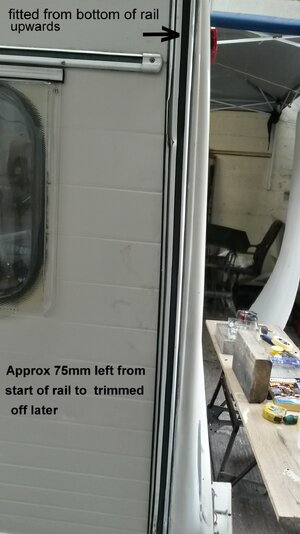

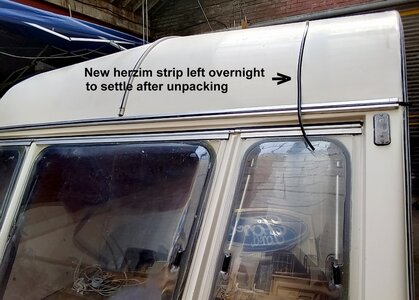

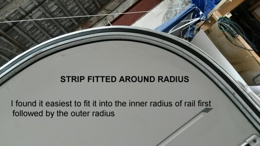

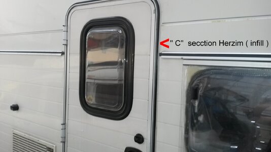

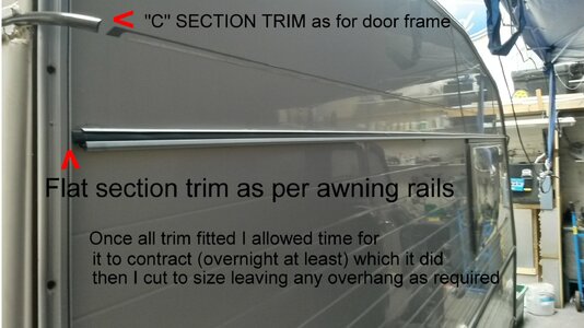

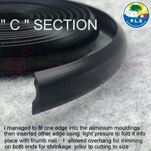

Thanks bud,,keeps me out of mischief,not a hard job to do,,The C section strip is "notched" on the inside and like the flat strip was quite pliable unlike the old material,,I didn't use or need any heat I found however it contracts once fitted,to be expected really (Important to leave a bit extra overhang and give it time to settle,marked the strip and rail with marker pen thus seeing how much it moved,
