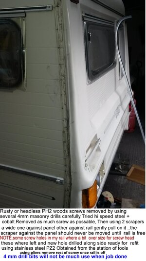

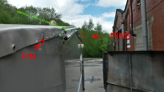

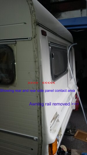

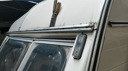

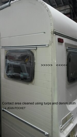

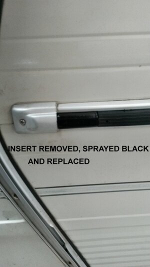

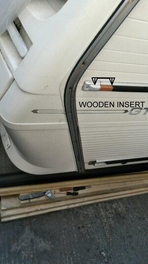

Awning rail reseal refit
Hope these images are of use for reseal of rails
