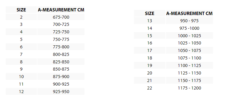

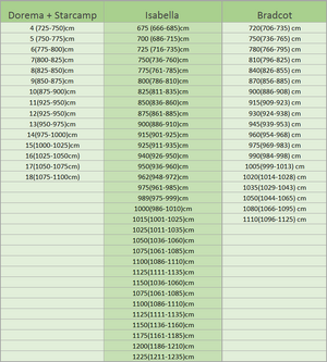

As a back check what does your Owners Manual say.
Not all awning manufacturers use the same number for a given measurement.
For example

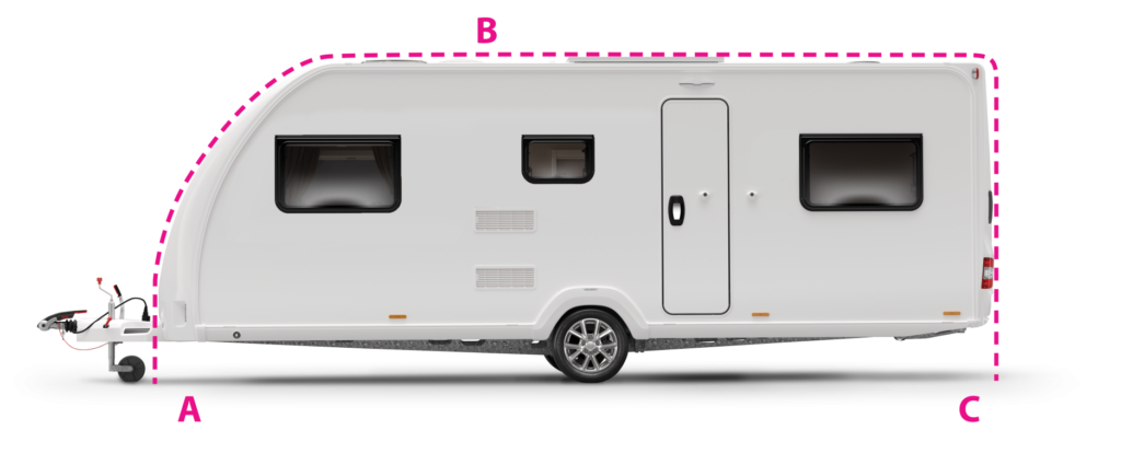

For Dorema awnings, measure your caravan through the awning rail from ground to ground (A-B-C) as shown in the diagram below. Then check your measurement against the chart. This will provide you with the Dorema awning size required.
SEASONAL CARAVANNERS PLEASE NOTE​
Dorema strongly recommends that anyone seasonally siting their awning should measure the caravan on the seasonal pitch prior to ordering their awning (for example, a pitch with decking could alter the awning size required).
In your case a Dorema no 12 will be correct. The 13 is much larger .
However if you research Isabella they use a different numbering system.
If you go too big you will have problems tensioning and pegging, the canvas sitting on the ground!
