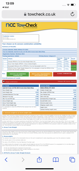

The reason I started looking at this is down to TowCheck’s report which I’ve hopefully attached. So, they’re wrong?IMG_4855.png

The car can legally tow up to 1500kg. The plated weight of the 575 is 20kg less than 1500kg however the approximate MIRO of the car is 40kg less than 1500kg. You would be legal.

The reason I started looking at this is down to TowCheck’s report which I’ve hopefully attached. So, they’re wrong?View attachment 5732
The figures for the caravan are incorrect. These are the figures off the Elddis website.
Plated M.T.P.L.M: 1480kgs / 29.13cwt
Maximum M.T.P.L.M: 1550kgs / 30.51cwt
The weights for the car could also be wrong as they are different to my source with indicates that the maximum towing weight is 1500kg and not 1700kg. Your VIN plate with maximum axle loads etc are the true values.
17,725
3,144
If you look at the top section of the form where it says Driving Licence Category, You have it as "B". Based on the criteria of cat B the calculation is correct, the combined MAM (MTPLM + GVW) exceeds 3500kg. so the form is correct.
Where you have gone wrong is that in Dec 21 the Government changed the category B licences issued since 1997 to automatically include "Be" and whilst you present licence card may only show Cat B your records will have been updated to report "Be".
If you were to rerun the suitability test but using " Be" as your licence it should report it all as legal.
A word of warning, whilst the UK records will automatically show you as having Be, if you travel abroad, the florigen authorities only rely on what's your licence card, so If you intend to travel abroad apply to the DVSA to replace your card for one with the updated categories.
I didn’t actually specify anything during the input, the question was simply “when did you pass your test - pre/post 1997”. I’ve emailed them anyways, just to check it all out.
