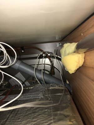

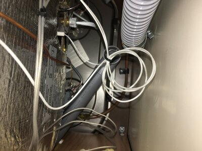

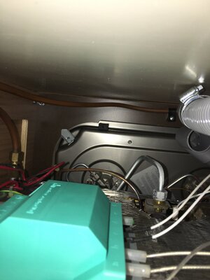

Sink wast pipe has dropped off. Because Bailey are unable to tighten a jubilee clip at the factory the corrugated vertical down pipe has dropped off the 90 degree bend located under the rear left hand side of the 3 burner hob. I have tried my best to describe this before on this forum so please note the problem is I cannot figure out how to gain access to this junction . It is not under the sink. There is no drawer under the sink. The fridge is under the sink, the repair is a 30 second job. It is access that is the problem. So I need to know how to lift up or remove the Thetford 4 burner hob so I can access this pipe junction. Surely, please. Someone should know. We can’t use the sink as the wast water drops down into the cutlery drawer at the moment.

Purchased 2022. Yes I know all about the dire warnings about the gas fittings. I have no problem with the gas I am an engineer and have all the checking and detection equipment. I just need to know how to gain access to this pipe junction. any help appreciated.

Good photos presumably taken through the drawer aperture?
Is it possible to get an arm / hand onto the pipe?
What’s on the other end of the solid pipe? Coming at issue from the other end?

That is the push fitting that has dropped out, not the jubilee clip loose, otherwise you wouldn't have the connector still on the corrugated hose.
Can you do it by taking the sink out?
My guess is you will have to remove the caravan's oven sufficiently to gain access. They normally have a gas supply pipe that allows them to be partially pulled out.

Can you remove the plug hole from the sink? Our Swift had the pipes fall apart and I was able to remove the plug hole, replace the flexible pipe and drop the new pipe down the plug hole and reconnect at a lower point to the original pipe that I could reach, then managed to pull out the old pipe
Its almost certain the caravan manufacturer will have assembled this part by bringing all pies and other supplies to the frame that supports the sink, then offer the sing to the frame and making all the connections before sealing the sink into position. Repair will almost certainly need the reverse procedure to lift the sink from the frame to access the connections.
.......the OP's post and the pictures provided clearly show that the joint that has come apart is below the gas hob at the back of the gas oven in his caravan.
The pipe tracks almost horizontally from the sink probably to avoid the caravan's wheel arch.
The sink is mounted in the adjacent compartment over the refrigerator and doesn't leak until it gets to the parted pipework.
