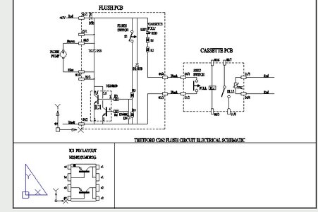

We need the toilet model . it can be rotted wires inside the cassette area. On some toilets there is a small pcb at the back of the cassette locker (C262) with a relay and a polyfuse( a positive temperature coefficient thermistor which will go high resistance in an overcurrent situation) and a reed switch which indicates when the cassette is full. the wires to and from this pcb and the pcb itself can come corroded, particularly at joints , causing the loss of voltage at the flush switch pcb. attached is a schematic I reconstructed when troubleshooting various toilets.

Not sure if the C260 is the same as the 262 but on some suppliers the reed pcb for the C260is the same as the 262 the pcb is behind a plastic panel and the back of the cassette locker , secured by two screws. and not if there is a high resistance joint/wire/pcb track.

This is a reconstructed schematic of the wiring of a C262 I had a similar problem with and having traced the wires , I determined the wires from the lower pcb to the upper pcb had corroded , so each time the pump was activated the voltage to the pcb dropped away .
