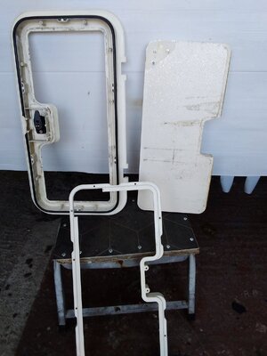

In my experience the door comes off by removing a pin from each hinge. The pin may have a keyway which needs lining op or removing before the pin can be driven out.
The door should prize apart and you can insert the core from your old door.
Ah ! I thought the core and the door were the one piece ? If they’re different, then it’s just the core I need, as that’s what the threaded retainers are injection moulded onto…..
Not sure you understood my post, but I could have worded it better.
The door is made up of a core and a frame. The frame has the hinges and lock attached. The core is the caravan colour and is interchangeable.

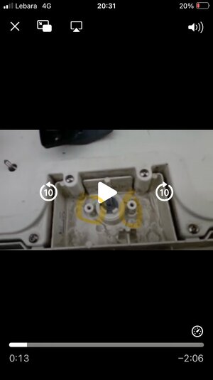

This video helps show the frame without its core. Other YouTube videos may help.
Thanks for your reply John, it never occurred to me to look up YouTube videos!
After searching, this is the closest I could find…..the door seems to have an inside and an outside. I’ve highlighted on the pic attached the two plastic threaded ‘boss’s’ that have snapped off, but they appear to be moulded onto the outside panel in this case ?

Thanks for the info and photos guys.
After seeing ‘toads’ disassembly, I reckon I’ll get the full door, then throw the panel in the bin, as I can fit the old one that has the coloured decals on it

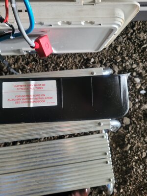

Good tip re battery tray- I’m on way to refit it now as have removed and charged battery at home over winter, and mobile service guy coming this morning

That what they did with my cassette door it had warped, put the old panel into the new door but ours was done on warranty .

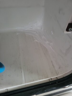

I found the image of the other end of the battery box. The square end if fitted the wrong way, cracks the housing as shown, lots of sealant in mine now.
