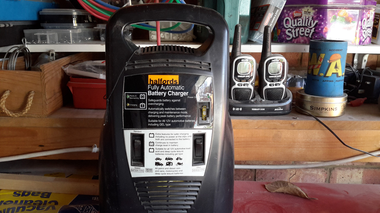

Yes the caravan charger does all the fancy stuff upto the 14.4volts then down to the 13.8 volts.
Its my home charger that I was interested in, its an old Halfords one that charges at about 13 volts. And it works well, on the odd occasion when I bring the battery home to keep it charged,
Should I be buying one of these CTEK chargers. Would it be of any advantage.
