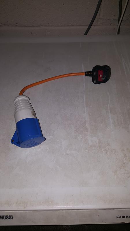

Hi , all you need to do is hook the caravan up to the house switch your switch on in the house and that's it , battery charging , you shouldn't need to put anything on in the caravan . However you will need a small connection that will go on the end of your electric hook-up cable to enable you to plug it into your house with the normal plug
