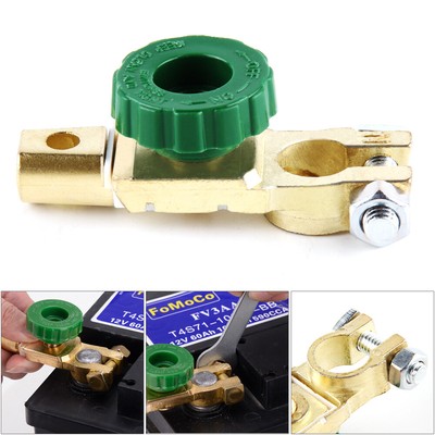

Baron v GB, I had the same problem on my Coachman, battery discharging a bit quick, not a problem when going out every month but chased it down to the fridge electronics and the radio ( even with the front panel off ) rather than pulling the fuses every time I left the caravan I fitted an isolator terminal, It works well, but winter months I still take the battery home, as not knowing when we will get out again.
