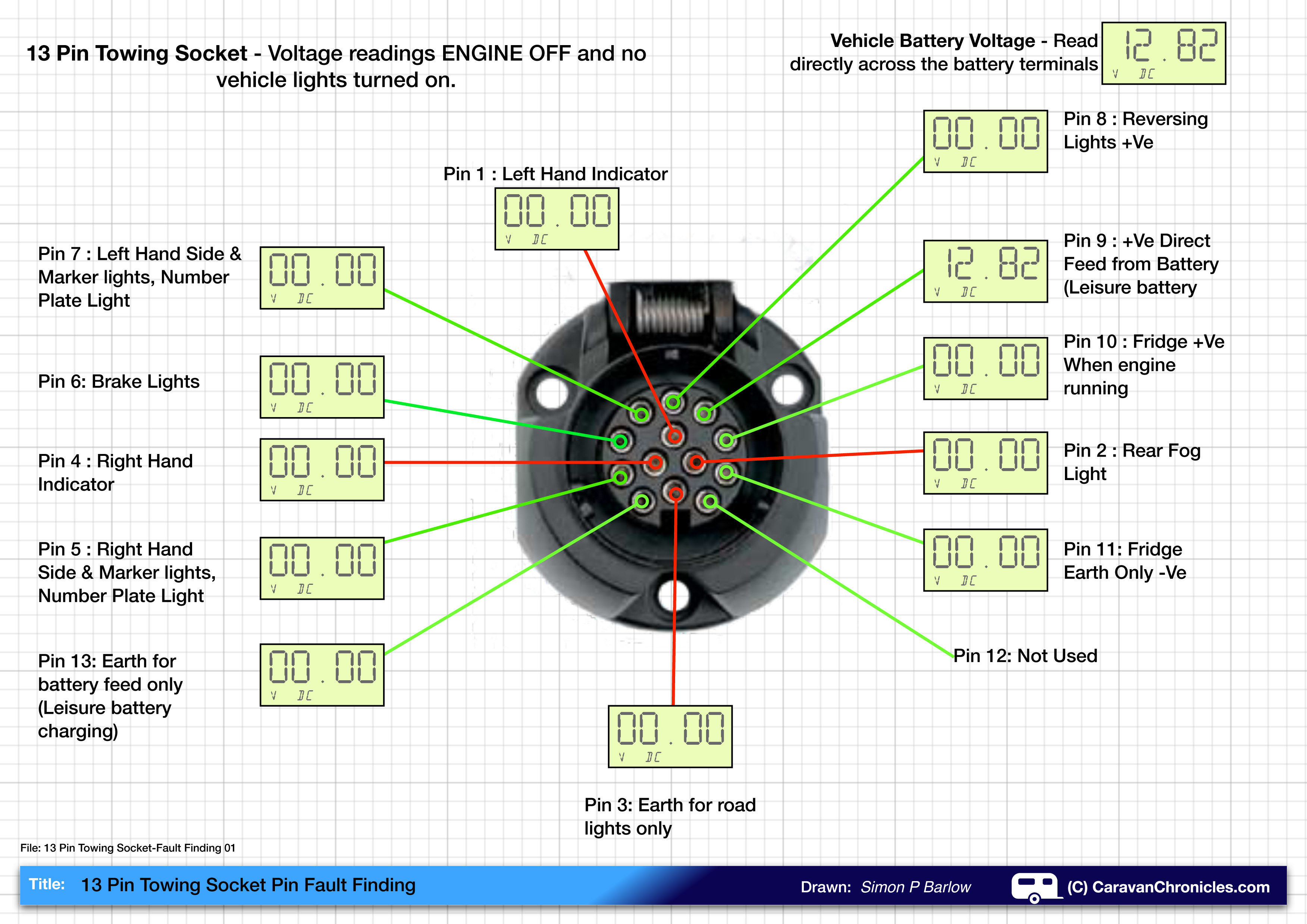

However the most likely fault causing your problem is12 volts being present at pin10 in the electrical socket of your towbar.
There should only be 12 volts present at pin 10 when the vehicle engine is running or the ignition is switched on.
You can test for this yourself even if you have no electrical knowledge.
Here is a wiring diagram of the socket of your towbar.
With your car engine and ignition turned off test for any voltage across pin 10 and pin 11.
You can do this with a test bulb or a multimeter.
I suspect you will not have a multimeter so get yourself one of these vehicle circuit testers they are cheap and always useful to have.
I made my own test bulb for pence and always carry it in my car.
If you find a voltage across pin 10 and pin 11 then that is your problem.
Remember there should only be a voltage across these two pins when the vehicle engine is running
