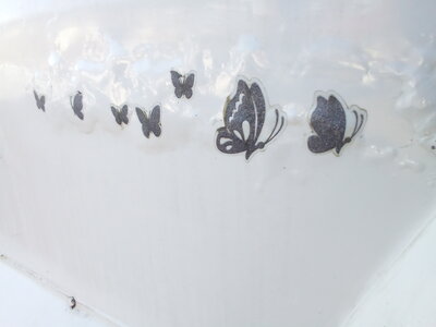

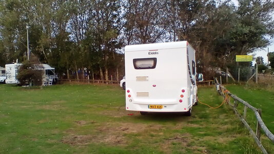

Hi I have blisters on the skin on my Motor Home are they repairable,
and if so how , I have looked on a lot of sites but no joy.
If anyone out there can help I would appreciate it , thanks
Sorry it's not very clear, it's on the right near the light cluster.

Welcome to the Forum. Sorry to hear of the problem with your motorhome. Even using zoom you are too far away from the vehicle to see anything in your photo. Can you get much closer and try some shots from different angles please.

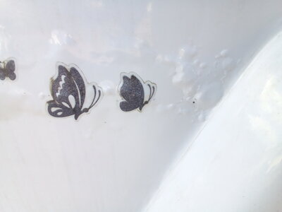

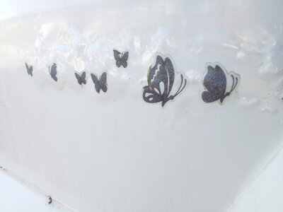

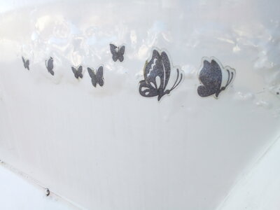

Hi thanks for your. quick reply , when I bought it there were a couple of small ones on the skin , but two years later they
have grown. and look very unsightly ,I'm not sure. What has caused it , and I don't know how the panel is made up , I can't
see any damp , so I'm a little stumbled..

South East Essex , thank you the white bits are the blisters .

Looking at those pictures, that definitely seems to be corrosion and if it is corrosion, I doubt if any body shop would touch it as they would be worried about comebacks.
With our caravan, we traded it in as soon as possible. On our car they had to replace the whole bonnet as no body shop would do a repair due to any comebacks. The bonnet was aluminium.
When was the vehicle purchased as that may help resolving the issue? However I think you may need to get expert advice on this.
13,966
4,111
What are you specific reasons for doubting a skilled vehicle technician or other other person with metallurgy experience would find difficulty in repairing the superficial damage
Simple they are experts and if they state it needs to be replaced as they cannot guarantee any repair, who am I to argue? I am talking from experience with a caravan and also a motor vehicle.

The Problem lies in the chemistry of aluminium. Once the corrosion , a chemical reaction has started it is nigh impossible to get rid of it 100%. No body shop worth their salt will take the job without loads of caveats. It may look good for a year or so but the blisters will probably start again.

In our case the expert was recommended by a good authority who had a vested interest in the repair. I had to accept that they used experts. Even cutting aluminium and then putting in a patch cannot be guaranteed.
As you are probably aware aluminium stretches and cannot rectify a "stretch". If you are unsure why not speak to an expert?

Everyone has assumed this panel is aluminium, it may of course be GRP, and if so those areas can be ground out and filled.
Either way I would recommend you find out who your local coach firm use for their body repairs. Motorhomes, caravans and coaches are very similar in construction so they will have first hand knowledge of suitable repairs.
I would not go to a car body workshop as they will not have the in depth knowledge of a coach/bus repair business.
Some years ago I damaged the rear (GRP) panel on my M/H, I visited my local coach repair workshop to get a quote as I envisaged an entire new rear panel. They repaired it for less than my insurance excess!
