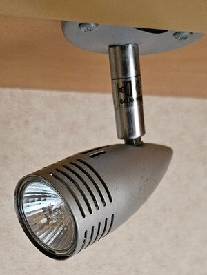

Hi everyone can anyone help me on how to remove the bulb in the spotlights above the bed in my Baily Ranger GT60 520/4 2012 Model please see pic attached

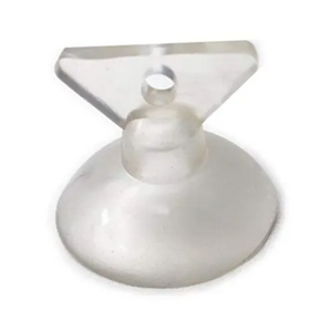

In my bulb kit I have a couple of small 'suckers' like these
1729250860077.png which you will find on eBay etc if you search 'LED sucker'. Enabling easy twist out or in of the bayonet type bulbs in your fitment.
On that photo you attached, there's a little sticker suggesting it's got a G4 capsule lamp base. In which case I'd expect to use a sucker and pull it straight out - it would have two straight pins that engage into tight springy sockets, and looks like an MR11 bulb that uses that base, I think.

I replaced mine with "cool" LED,,a brighter light,they don't get hot and hopefully last a bit longer,I removed mine by gently pressing in with my thumb and jiggling left and right
