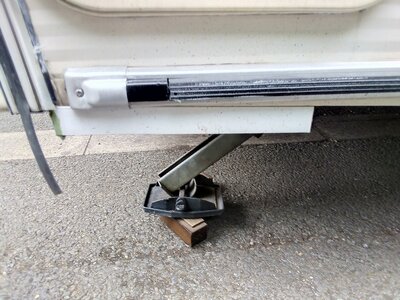

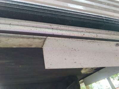

The black block that can be seen in the bottom image is part of the repairs I did to the "buffer rail" I couldn't find any to replace it, but that's another tale as they say

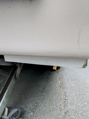

the water that flows down the awning rail hits the PVC angle drops to the floor,otherwise it can flow down the panel and collect on the underside of the caravan

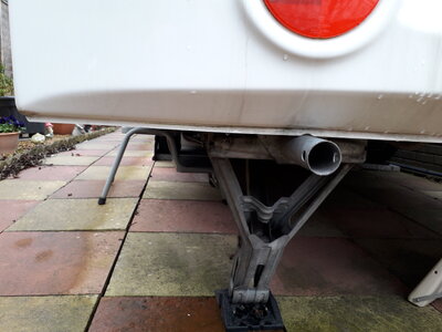

Just bonded on with Sikaflex looking from the back, in front of the row of screws fixing the back panel,so that it drips of before being able to soak through the screw holes, Also done the sides from the rear to about 300 mm along.

It could be a couple of images I put on,I used 25 mm X 25mm PVC angle(cut to 90°) fastened on using shirt stainless steel screwsView attachment 9052
Can't help but be intrigued why you ended up with this arrangement of blocks and shims under your support leg? Please explain!
Perhaps it was before you found that you could raise and lower them with crank handle?
Or maybe your added plastic skirt had a return around the corner that covered up the hex winder?
:unsure: :grinning:
Sep 23, 2023
1,082
413
1,435
Keeps it more stable,ie the more extended the jack's the more the caravan can rock, usually I use higher blocks than those.if by fitting the PVC angle it caused any other problems it wouldn't of been fitted
