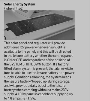

Was just down to the caravan last week (in storage) to pick up a few things, and noticed there was an orange light on the solar panel box in the cupboard,
Switched on the power boxes under the seats and all the fuse breakers were ok and in correct position.
The power didn’t switch on which presumably means we have a flat battery
I was told by our yearly service guy to always ensure the breakers etc were all switched off when in storage, have I been told the wrong thing and the solar panel hasn’t been able to trickle charge the battery?
Also is getting the battery charged back up a quick fix, or shall we just leave it will we are going out again and the car power will charge the caravan battery on route to next site, or should we be doing something now to prevent a bad battery?

Very odd how my battery can be drained, if the below is true
I know the Sargent Alarm works because it beeped when I arrived and when it was armed
I’m going to head back down this week and check again
