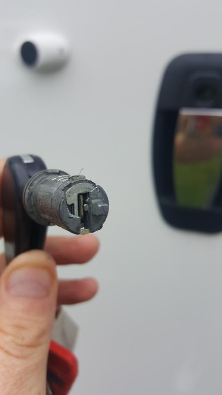

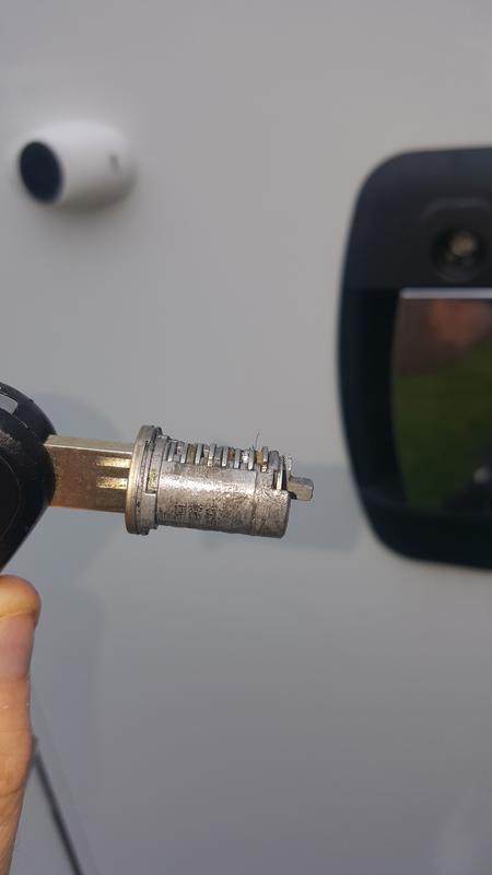

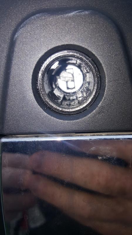

You've jinxed me again this forum ! when ours went in for a service a few months ago , we asked him to have a look at the lock as it wad stiff , it just looked like they'd put WD4o in to it !
Anyway this morning was washing it plan was to take it back to the storage but not now) gone to get into it and the barrell has snapped and come out with my key ! :( sick as you can imagine .
I've managed to put it back in and lock it securely but waiting for the garage to open now. :angry:

Yes it has snapped as when I've took the key out it's come out with the key & little metal bits are still in the hole !
I've managed to put it back in and secure it and its not a stiff lock , its a broken one . The garage is on route to my storage facility anyway so it's not out of my way .
