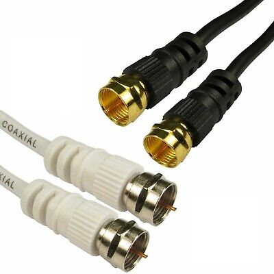

Its worth also buying a few adaptors for normal tv as well.https://www.ebay.co.uk/itm/Satellite-Coax-Male-Adapter-F-Type-Female-to-RF-TV-Aerial-Connector-Coaxial-/352612381282?mkcid=16&mkevt=1&_trksid=p2349624.m46890.l49286&mkrid=710-127635-2958-0
