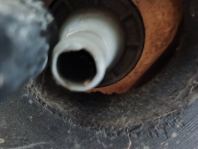

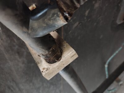

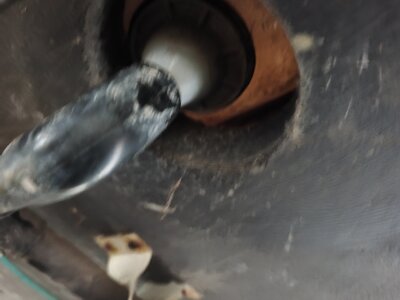

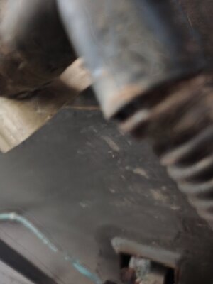

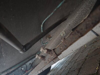

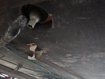

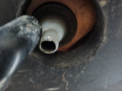

I have been seeing what might need updating on my caravan and have noticed an issue with the waste pipe
There appears to be a sprigit which is from the bathroom area and this is loose has no connector and water cones out
It does not have any connector us this a jubilee clip missing
The pipe is not in great condition so I was thinking of replacing it with rigid DIY pipe
But was unsure how to fix to caravan re drilling into the floor
I also wanted to put two outlets with the flaps on at the side if the caravan for easy access

I would suggest you use flexi pipe, its a lot easier to route than rigid stuft. You can then locate the outlet exactly where you want it, perhaps marrying it up with the kitchen waste outlet?
The outlet units simply screw into the caravans plywood floor. Probably best to use stainless screws rather than mild steel.
The downside of flexipipe is that debris collects in the corrugations which can increase odours and reduce flow and can form a downward loop which acts as an unwanted water trap. An alternative is smooth bore pipe, used in garden ponds, but the downside of that is weight!
Manufacturers tend to fit rigid pipe under the floor - I modify it with blocks to give a gentle down slope towards the final outlet.
In 20+ years with MH's and caravans I have never had an issue with clogged pipes, or nasty niffs! But I DO always put a good glug of bleach down the kitchen sink after every emptying of the waste tank/waste master, that sits in the tank and kills any bacteria that might cause nasty pongs!! Works for us anyway.
Back to what the OP was asking , a jubilee clip won't work as the solid black pipe won't 'crush ' onto the spigot to make a sealed joint. My advice is to get some plumbers mait from B & Q ( other hardware shops/merchants will stock it).Apply a liberal quantity around the spigot and press the back drain tubing onto it , then using some 15/22mm pipe clips secure the black pipe to the caravan floor close to the joint to stop it from coming adrift . You can finish off by wrapping gaffer around the joint but that shouldn't be neccessary.
