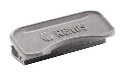

the window blind clips seem to be falling off really easy, has anyone glued/sticky taped them on before to prevent this?

"the window blind clips seem to be falling off really easy, has anyone glued/sticky taped them on before to prevent this?"
If you're talking about one of these:
I usually stick them back up, using superglue (I was given this advice by the dealer from whom we bought the caravan).
See I thought about that but then thought if one snaps when glued on that could be another issue 😆
