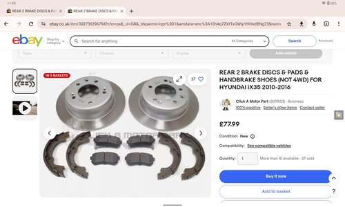

The 2014 Santa Fe has the hand brake / electric handbrake , operating on cables to brake shoes, operating inside a drum on the rear discs.
This morning I have just received a recall on the Hydraulic Electronic Control Unit, for a fuse rework.
So ten years old now, some manufacturers phased that system out decades ago…..You live and learn. I have not worked on vehicle brake systems for around d 30 years.
And you still adjust the handbrake shoes through a hole in the disc drum. Old tech, but easy, unlike the handbrake module to operate the cables.

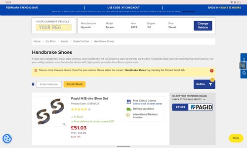

I guess my Tucson must be the same, very old technology that.
If it ain't broke, don't fix it - drum brakes work just fine for parking brakes, they don't get hot in use so don't need the better heat dissipation of disc brakes.
But using the rear disc brake as the parking brake is old technology in itself - my 1967 Fiat 124 had a parking brake that operated on the underside of the rear disc brake piston within the caliper.
