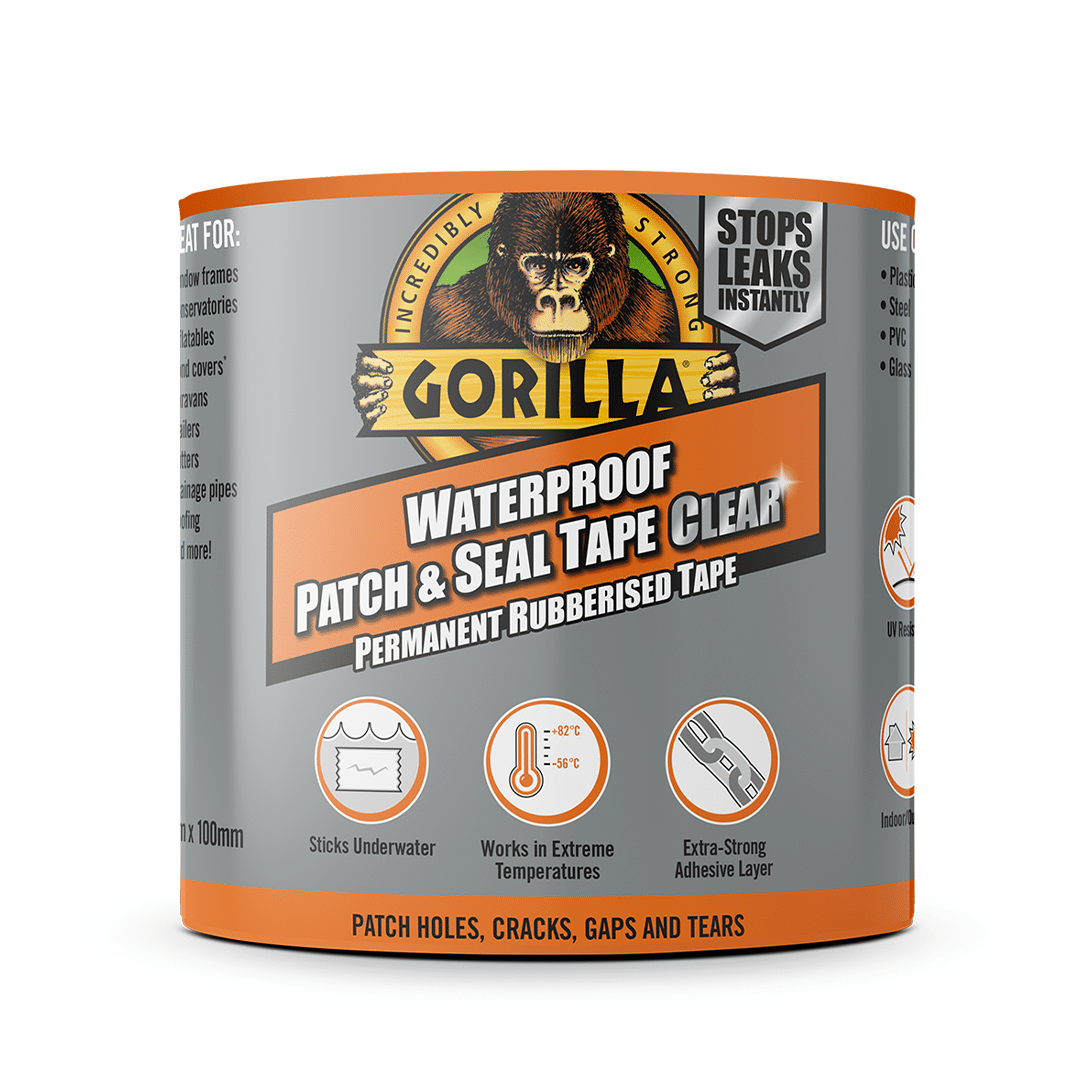

An alternative cheap and much easier repair that I'll probably get shot down in flames for suggesting! would be to glue the crack with an Cyanoacrylate Glue and cover with Gorillaglue's waterproof clear tape, its an amazingly strong and sticky tape, a virtually invisible repair that won't be seen because its on the roof. If it fails after a few years what have you lost?
If the product was still under warranty, then the type of repair you have suggested might not be advisable, as it could compromise the manufacturers repair methods.
But if there is no warranty to be claimed then why not try it.
