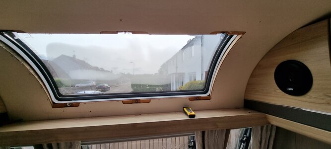

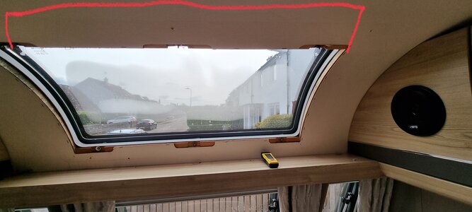

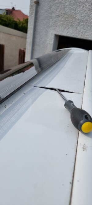

I'm looking for a bit of advice. When we took our van from storage this year there was some damp on the from from the curved window down (it's a 2017 Elddis Cursader Tempest). After looking at a few photo's of someone else's I thought it might be the seal at the top of the window, but when I got up to look, I found something a lot more serious, a massive crack in the front moulding!!! As the van is out or warrantee (as a person who's new to caravanning I can believe the rubbish warrantee conditions). I'm planning to fix this my self. My plan is to removed the inside facing board, use some plastic welding clips to join the pieces and then fiberglass over it for a water tight seal.
My key questions are
1. How so i removed the facing board as it seems to go behind the cupboard etc. Do i need to take those out as well
2. Does my plan make sense or is there a better way of doing this
I'd appreciate any advice.

Back in the 1980's I saw many caravans being constructed, but since then the manufacturers have changed their materials and assembly methods. (and still not good enough in my opinion), so I doubt what I saw has any direct relevance today.
Looking at the interior picture I would agree it seems the wall cupboards may need to be removed to gain access to the edges of the interior roof panel, But I can't tell you if the cupboards can be removed from the wall independently of anything else.
Whilst its possible a forum contributor may have undertaken this kind of job, I think I'd be inclind to find a local caravan repairer and to ask them. The worst they can do is to reuse to give advice, but they might be more helpful than you think.

If it means removing cupboards and that shelf, and all that that entails, I would be tempted to use a multi-tool to cut a rectangle as indicated by the red line. Some ‘T’ section plastic strip could hide the join on replacement.
Not ideal I know, but a possibility.

I would suggest that you contact Premier Towing Services in Birmingham to do the repair on such a new caravan as it is on 6 years old. They come highly recommended and they quoted me £600 for my front panel.
However there may be some good news if the caravan was bought new from a dealer. Despite the caravan being a 2017, there is a possibility you may still be able to have a claim against the dealership.
Even better if the caravan was or still is on Hire Purchase. We claimed on our 2018 which was bought in Oct 2017 and we were successful.

This cracking is a known fault with Eldiss caravans and depending on when you bought it if through a dealer you might have a claim against them. Second hand purchases are still subject to to the CRA and if bought either using a credit card for part of the purchase or HP you can claim against the finance company.
To enable us to advise please let us know when it was purchased and if second hand was it from a dealer and was any finance involved. The advice will be just that though, and if you are a member of either of the two clubs they have a legal help line butd if not Citizens Advice can often help.
Disagree with the prof on this one, I would explore two other options BEFORE removing the internal wallboard.

A bit of an update. Thanks for all the replies. I've taped up the split with white tape for now and as per some of the Advice above, started to get in touch with a few different repair companies and Elddis themselves. Still waiting for a response from Elddis to see what they say. I bought the van privately which I think leave me with an issue on both the warrantee and dealer. Its my first caravan and while we love getting away, the support and quality put me off.
I've only got one quote so far and it's from an Elddis certified repairer, (the other 2 came back with too big a job or we only repair vans we've sold). They would removed the window, plastic weld and then paint. Cost would be £900 + parts, which would include a new window c£850. I'm pretty sure I'd need to add vat to those amounts! I worried that if that's the approved approach then getting access from the inside could be a night mare.
Part of the message also suggested this was a repair they see a lot.

Thanks for this. I'm planning to have a look at the cupboards at the weekend but if i did have to cut it, how well would hte T section work on the curved surface?
There are two basic types, one fairly rigid which would be difficult. But there is also a very flexible one used to edge boards. This would easily cope with the curve.

I've had another quote and this company have suggested it will need a full new panel which is £5-6,000 before they quote for any damp work! So suggesting I make a claim on my insurance. So at the moment I have a couple more quotes, have started a email to Elddis to make a claim based on it being a common issue because of a design fault and will be phoning my insurance company to understand their perspective.
Having never had anything like this before, it would be good to understand if I was to fix it myself, would allowing it to dry itself be okay once the water ingress had stopped or do I need to do something else. There's not really much of a water stain, but the moisture level is almost 40% in the worst places.

When our claim was rejected by the dealer and Elddis they stated that the crack was due to the caravan taken on poor road surfaces. I regarded this as accidental damage and put in a claim.
The assessor viewed the caravan which was at the dealership and could not find any evidence that the crack was due to accidental damage. While at the dealer he inspected a few other caravans that also had similar cracks. His conclusion was that it was a design fault.
As his report was professionally done, neither the dealer or Elddis could dispute my claim. The whole front panel was replaced after we agreed to paying £600 towards costs saving is £8600. However ours was bought from a dealer and had a full service history.
It can be repaired without the need for the front panel to be replaced so beware!

Nealmc, the plastic weld method was the way I went with mine, I like you was prepared to have a go myself, and after purchasing materials and stripping the inside it became obvious it would be harder than I thought with no real access to the split so went with a professional repairer.
Before stripping out the interior the two options open to you are, one as in the post above, remove the window or my first option would be to remove the joint strap and access from there, you will need to slide a piece of 4mm plastic under the split so it gives it more bonding area.
Why they have suggested replacing the window is beyond me, why cant it be removed and replaced? With removing the joint strap you will at least have it resealed on replacing, more piece of mind.
Here's a link to my post CLICK HERE
you will also see other links in the post from other contributors on here making recommendations.
There are also pictures of the inside stripped out which shows the window frame being 6" wide (150mm) so restricting the access to the split.
If you can find a local plastic welder I think this would be an option for you, if I remember correctly it was approx £450.00 to £500.00 but he did 5 repairs around the window this also shown in pictures in my link.
