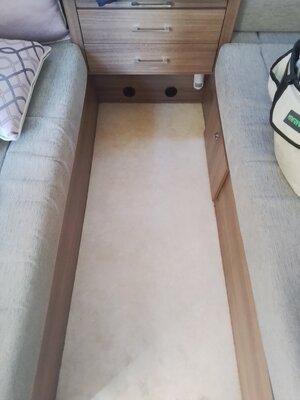

No it’s more towards the front of the van where the bench seats start up to the sideboard at the front in front of the water tank probably about 30 to 40 inches down the middle showing readings 40/50

Yes but readings only 15 to 25%!under bench then 49 % in front then goes 11% 10% 9% they could not find anything leaking and no signs of damp at edges think it could have been an old leak but we’ve not been aware of any not noticed carpets have been wet

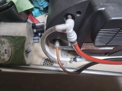

A while ago I suffered a failure in the valve at the top of a combi boiler that allows air in when the drain valve is opened. Its the white one at the top of the picture. With the clear drain tube dropping down through the floor. There was no drain tube fitted on my caravan to take that water down through the floor (not fitted at the factory, but of course it was impossible to prove that) So water dribbled out of the valve when the water was heated and tge system was pressurised, onto the vinyl and across the floor. Wet carpets are what alerted us when we got up for breakfast. It ALSO got a long way under the vinyl so in order to dry it out I had to remove the vinyl.
When I did so I found an area around the gas drop vent, and the hole where the drain pipe should have been ( both visible as grey things in the picture) was discoloured due to clearly a previous minor leak I had not spotted and had dried out
The water in the discovered leak had made its way, under the vinyl (over a maximum of 24 hours because that's how long we had been away) all the way back to the bedroom threshold.
Even after mopping up the water, that had only been present for a short while on the ply surface, my floor took 10 days, using a dehumidifier, to dry out to around 15%
So this caravan could have suffered a similar incident but the vinyl wasn't lifted to dry the floor out fully. The "edges" of the damp have dried over a long period, but the middle hasn't.
Well thats my theory and it's worth consideration because it's based on personal experience.
I would want to see whats under the vinyl flooring!
