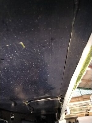

I had my service on the caravan done yesterday. The damp check indicated some raised levels around the nearside wheel arch - 20 to 25%.
They sent a picture (attached) of the underside that shows the floor is not quite tight up against the side. They suggested some sealant which I will do but I also have some of this decking tape and thought maybe that would also help.
Also it occured to me that this may be a temporary rise in the level as the journey to the workshop was in heavy rain and lots of surface water that is always more on the near side.
Also has anyone used a fan heater to dry things out in a small area like the wheel arch which is in a cupboard. Where else would you keep it :)

In May 2021 we had a very wet journey to North York Moors and the weather did not improve over the subsequent 2 weeks. We had been discussing selling the caravan, but that holiday decided us. So in getting the caravan ready I had our AWS tech carry out a full damp test some three weeks later. The overall levels were okay but had been better, and nearside wheelarch area was around 17%. The tech said it’s okay given the recent wet usage and it should dry out. It did and the AWS gave me a FOC repeat survey around the wheel arch and adjacent flooring together with another report.
Given that mine was incurred in May and tested in June/July I let it dry naturally. Yours might benefit by some local heat. The tape can’t do any harm, and could you plug the gap using electricians putty which is waterproof and stays flexible.

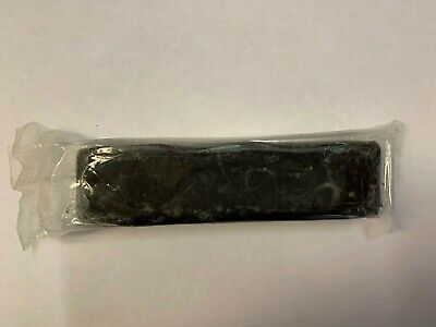

I’d favour Electricians putty as from experience it weathers very well. Not sure plumbers mate would be as good. I used Electrician putty for waterproofing the terminal contacts on my movers. Never had any water ingress issues again. Readily available on line. .

Here’s what I purchased.

How was this joint originally sealed at the factory?
If the joint for whatever reason has opened up and the damp readings on the “inside” are abnormal then some form of sealing may be required.
I’d use a caravan manufacturer approved sealant like Soudal RV 61 or Sikaflex 522.

I see a lot of caravan floors from underneath and the manufacturers use a sealing tape to cover joints . its not duct tape but is similar . I found the electricians sealant a little hard when cold , plumbers mate is quite soft and will 'sag' over time unless supported ( its great for picking up screws in inaccessible places)I 'd go with soudal fix all or equivalent and then tape with gaffer(duct/duck) tape

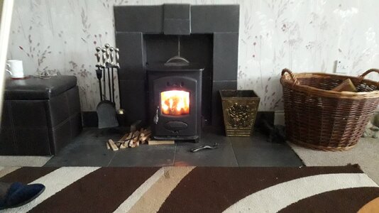

My fire is slightly to small for my two bed bungalow, in fact it is a narrow boat fire. I normally burn dried hardwood, This year I have some cherry and apple, two years drying./seasoning. Burn fast, very little soot in chimney . open all the doors warms whole bungalow.

I went under the van today to look at the problem in the photo and try and fix it. The gap is between the side walls and the floor. Its only about 1mm wide at the bottom but doesn't appear to go all the way through. No sign of movement so I suggest its just another quality installation :-(
The gap was too small to squeeze any meaningful quantity of sealant in so I just used my 50mm wide deck joist tape which is supposed to be waterproof - its certainly stood up well on my deck. It's bridged the gap very well and I'll see over winter if it stays stuck on. Certainly stuck to my fingers well.
Of course while underneath I took a look around and it just confirmed to me what a shoddy design and build caravans are - and I don't suppose its just mine. String and sealing wax came to mind but I suspect that would be an improvement.
I noticed a gap that had opened up slightly on one of the kitchen side panels were the oven/hob is. It butts up to another panel. No gap at the bottom - 2mm gap at the top. Worktop coming away ever so slightly from the wall but you can push it back. I got my Boroscope out and stuck it up between the oven and the panel to see if I could spot the problem. There's a piece of wood that bridges the gap and is supposed to be screwed to both panels to hold them tight together. The screws at the top were not screwed up very much so weren't actually doing anything. I managed to get my arm up there and screw them home.
