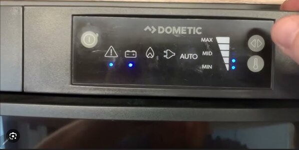

We have always used the electric for the fridge. But recently my daughter and son in law used the van for our Grandsons moto x meetings. They have tried to put the fridge on gas, and the fridge was warm. I have investigated to see that the gas is on, the pilot light is on and the burner is hot, but still the fridge is warm. Yet it works on electric fine. Any ideas please.

Your picture shows set on Battery and the warning triangle as car is not connected with the engine running, Set it on Auto with the gas on and if not on mains it should light automatically on Gas.
Sorry, yes that was just to show what type of fridge we are dealing with.
