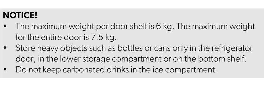

Oh my! I too have now read about all the issues re the Dometic fridge-freezer and now paranoid! We are away in our van as I write this and just read a section on the Dometic instructions warning about maximum weight in the door. Went immediately to the fridge to see what we have in the door..argh!!! 2 x 4 litre bottles of milk, each weighing 4kg! So our door, along with a couple coke cans and other bits and bobs must be 50% over weight. What an eye opening, will be re-stocking it now more carefully.
Thanks for the reply Robbo, it is very nice to have someone to hold their hands up and state that they got something wrong , which could cause the problem. The number of times I have "asked" Mrs H to put the milk carton on the shelf closest to the hinge to stop the door from dropping.
Reactions: Robbo4545
I used to cringe at what my wife used to put in the fridge. Numerous times I had to bring to her attention that they do have shops in Scotland and lovely big supermarkets in France.. My phrase would be “ Operation Minimise” is live. What a waste of breath.

Unfortunately or fortunately a fridge is built to keep goods cool so whether it has no shelves or 10 shelves it is still fit for purpose.
As for weight on the door, one would think that common sense would prevail, however it is easy to forget about the weight of items in the door and we are guilty of losing Mr Common Sense at times. :D
We would normally have the 3 litre milk and a 2 litre soft drink bottle in the bottom of the door plus of course the stuff like margarine, cheese which added up together may take us over the 7kg. Our 8 series does not have that warning in the manual.
The issue her eis that items like 2L bottles cannot stand upright inside the fridge whether domestic or in the caravan. Once opened we are not keen for the bottles to lie on their sides.
Remembering of course you can’t put heavy milk/soft drinks on the shelves, just the fixed bottom shelf according to the Dometic warning 🤦‍♂️.
