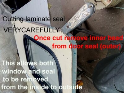

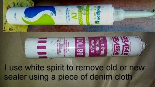

If the seal is like mine it is a one piece ," U". Shaped section moulding,with a another piece of cord fitted into a central channel,It probably was supposed to have a secondary bitumastic seal(when I replaced mine I used what I always use,a bitumastic sealer cartridge (ID 99 by caraflex or Hodges).Having said all that to replace a door window seal is a struggle to say the least, it's as though they're made a size to small thus gripping the door frame and window tightly,for yours to feel loose is a strange situation..I wish you luck if you can't find a solution as what has been stated by the various suggestions by other forum members,Gary

As a guide to show the seal in position...I was replacing inner door panel at the time
