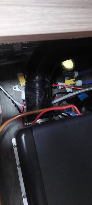

Hi just exchanged caravans now got a coachman acadia 660 extra . When setting up yesterday the water was going through the drainage tap I pulled the seat up and there was two yellow taps I turned them both up to stop the water which it did . Before in my elddis van it only had one tap .Does anyone know why there are two taps and what they are for ? Thanks
5,880
2,785
You probably have an onboard tank. Therefore there are two drainage outlets. Lift the yellow tab up and the pipes will drain out below the caravan. When lifted, the taps won’t work as the water has drained.

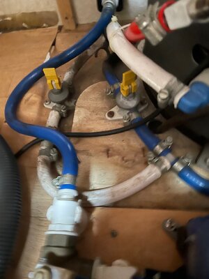

I have two. The second was a modification by Chipping Sodbury caravans . The yellow taps are part of the hot water tank , cold feed. Previously it would a take a while for cold water to exit the cold tap. It’s basically a bypass bleed system. I’ll post some pics tomorrow

What do you think of the Chipping Sodbury Caravans mod #14?

@Dustydog seems a bit of an overkill they are literally 150mm apart on the same line, but that tubing has a smaller bore than the more modern 12mm John guest pipework so as you say it speeds up the drain down.
From memory Ian we had a problem with a delay in the cold water coming through the cold tap cold! It was slightly warm! Don’t forget she’s 17 years old. Their mod has certainly worked well for us and solved at that time what was apparently a very common problem
