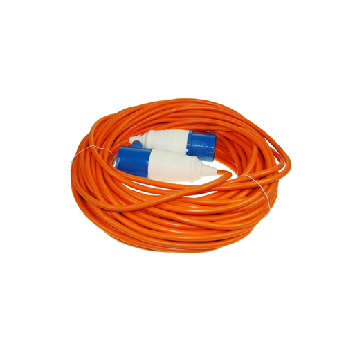

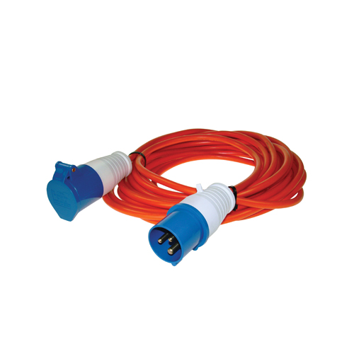

I did come across the link below. It seems that 'The UK & Ireland’s Leading Towing & Touring Company' are selling an extension cable that is 'Not suitable for caravan site use'. The cable type is stated in the description.
They also sell this one that they say is suitable for caravan site use. Zoom in and read the cable type on the bottom left of the box.
I think I'll buy 25m of yellow arctic grade cable - it's definitely more robust than H05VV-F.

"Artic "cable, unless this description is not a definitive product seems still to feature PVC insulation & sheath.
LINK
I thought your first link was an early April Fool🙃
Why on earth would a Caravan Accessory shop sell a NCC non approved EHU cable🙉
For non caravaning camping use, eg tents?
Plus, Maypole is rather more than just a caravan Accessory business.
25,574
9,364
It could be suitable for users camping in tents or fold ups.
