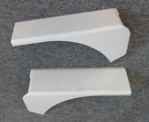

Google Elddis crack covers and you will see these. Before fitting make sure you have drilled small crack stop holes at the crack ends. Then for hairline cracks apply Captain Tolleys crack stop.
Top Rear Panel Corner Covers White - Swift Sterling Sprite Elddis Caravan RPTCC - Picture 1 of 12
