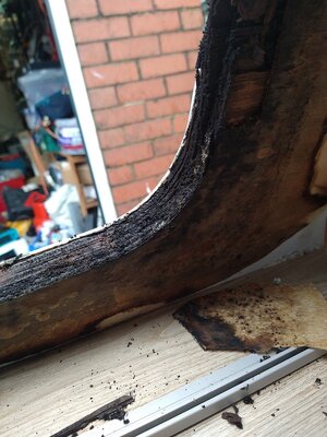

Wet,Wet,Wet sponsored by Elddis. Seriously, have the front and rear panels checked for damp. This one had a loose hinge bare on the RH front , it let water inside which rotted the front plywood ( Caravan is a 2020- with Solid construction) client was unaware of the extent.once the curtains, blinds and window rubbers the centre window and lh window frame were are wet/rotted, seems to be a common theme on Elddis caravans
