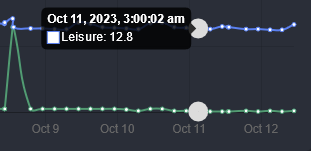

As an aside, I saw I can view all my battery stats on the Swift Command portal, so judging by this (12..8v during the middle of the night going to 13-14v during the day), I think the current battery is perfectly healthy. My money's on the smart alternator. The towbar company have said I can pop over whenever to double check the switched relay.

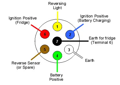

When we had the towbar fitted on the Jeep I was asked whether we wanted the facility to keep the fridge cool while travelling. I declined as in the past we had hardly ever used the facility finding that ice blocks kept the fridge cooler.

Fridge doesn't care where 12V comes from. Typically fridge 12v circuit isn't connected to house battery as it would flatten it over 8 hours. For travelling it is wired to separate circuit that comes from car ignition circuit.
Power is only supplied while cars ignition is on.
Most cars won't have this circuit wired to towing socket and in lot of cases caravans won't have it wired to their towing plug. Given extra cost of having it wired up at both ends most caravan owners decide to go without.

Here in the UK at least, fridges can run solely on 12v. This is a considerable load on the battery but depending on battery capacity could run for several hours before it needs recharging.
Later fridge models do require 12v for the control panel even if not using the 12v for cooling.
Again tow bar fitters here usually ask if you will be towing a caravan and do you want the fridge to be powered when towing. The answer determines the type of wiring harness.
Caravans I've come across in the last 20/30 years have the fridge wired to the towing connector for this purpose.

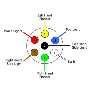

There is rectanglar 12pin avaliable for extra circuits like electric brakes. Some car owners still use round UK socket. In both cases car owner would want to have an adaptor cable as all hire trailers and most boats will have 7pin.

There used to be a 7S supplementary connector which carried battery charge and fridge circuits
