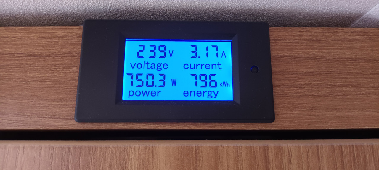

Both I and Jaydug have fitted a mains electricity meter to our caravans.
We both did a DIY fitment but this is not for the inexperienced.
Fitment involves a doughnut coil sensor being fitted with the incomming mains live feed wire though the centre of the doughnut coil.
In my case the sensor and associated wiring were all housed in an insulated sealed box beneath the caravan's front seating.
Monitor fitted above wardrobe.......
Monitor screen readout.........
Top left ........in comming supply voltage.
Top right......... real time amperage use.
Bottom left......real time wattage use.
Bottom right.....total kilowatt hour usage (can be set back to zero)
Cost of monitor kit was £10 from an online supplier plus £10 for insulated box and bits and pieces.
Would like a link to the supplier if poss.
I did the same a couple of years ago though hung on the wall instead of fitted in. It was excellent. I also only paid about £10 but from Ebay.
Mine was new but old stock labled as Southern Electric. but the rechargeable batteries failed. There are plenty on Ebay now but from about £40, An OWL is around £90.
