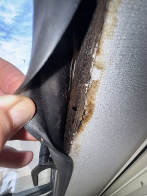

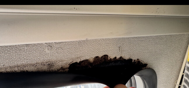

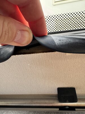

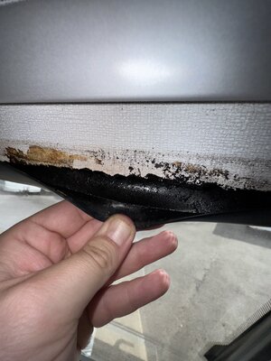

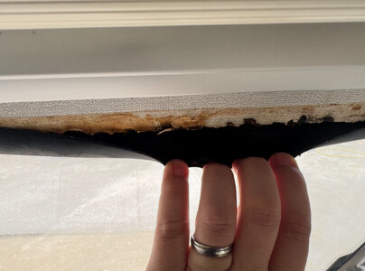

However… saying that, despite the dealer assuring me it’s no damp, and perfect condition, when left alone with the van on the front window I was able to locate between the seals, a considerable amount of black moulding, staining, marks etc. I’ve attached photographs.
In addition to this. If pressed hard on the panneling, I could have put my entire hand through the wood near the window.
As a first time buyer from reading the internet the thought of damp keeps me up at night as it’s the first thing people note.
The rest of the van appeared fine, with other window seals being clean and the wood appearing clean and strong.
Now I appreciate this is quite long, but I’m assuming, and don’t want to sound like an idiot here, but this van is a hard pass? as it’s clearly evidencing damp/wetness which would be a considerable expense to repair?
And with that, moving forward, again not wishing to sound like an idiot, but all vans should be 100% clear of this type of black marking / moulding as evidenced in my attached photo, like some of the seals on the van are fine.

Especially for first time buyers, it makes a lot of sense to use a dealer, as this gives you some very important consumer rights if things do start to go wrong.
But regardless of where you buy from you are correctly looking for potential problems, and the evidence of damp you have found cannot be simply passed off as being "nothing to worry about", that discolouration should not be there, and until its been properly investigated the extent of the problem cannot be accurately assessed.
If there is anything about a caravan that you find is not satisfactory the best advice is walk away. You have little idea of how much trouble damp problems can cause not just from expense but the effort to get any repairs carried out.
Through your research you have identified the models and makes of caravan that you believe will suit your needs, so shop around until you find one that matches your ideals with no apparent issues.

By your photos and description of spongy wall panelling that van has possibly been a leaker from leaving the factory and it may not be obvious where the ingress is occurring. A full damp report is important on any van you buy as around the windows would be a key area for multiple test sites. Maybe this is especially important for vans with a single front window. Walk away and keep searching for the right buy!
