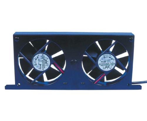

While the fridge is out, I'm looking to install a vent kit ready for the warmer weather when fridges have a harder time keeping food etc cold? nb especially Ice!;) The Thetford kit seems quite good? Any views at all on this subject please? :unsure:

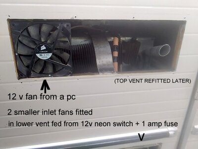

This has been covered a fair few times on this, and similar forums.
I have fitted fans on 6 different occasions now. One or two computer fans zip tied to the inside of the top vent, small (iluminated) switch inside fed off a nearby 12v supply that is dead when the master switch is off (if possible the lighting curcuit which ensures the battery doesn't get drained over a long period if left on in error)
Total cost about £15 and a couple of hours of my time.
I have never bothered with a thermostat as I cannot see the point (that's why I use an illuminated switch, it acts as a "reminder")
No problem over-cooling when its cold, the switch just stays in the off position!

Best method is to get two computer fans - 12V usually about 4" diameter - fit one in the bottom vent blowing in and one in the top vent blowing out - the direction of rotation and airflow are usually embossed on the outside of the thickness of the fan unit. If possible get two-wire fans as these are not designed to be controlled as the three-wie unts are. The fans should not be airtight in their mounting, indeed there should be plenty of open space around them - you will still need air to convect if the fans are not running.
Wire the fans in series - that is red of one fans goes to black of the other and the 'remnant' black and red are the supply connections. This will mean that each fan is getting about 6V which will take less current (power) and the fans will run at half speed which makes significantly less noise. You don't need to blast the fridge cooling fins with air, the fans just need to 'assist' the air movement a little.
