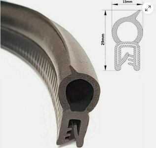

@Dubious , so the seal isn't being compressed against the lid? On most seals there is a 'bulb'- see photo- and a small lip , this should be compressed against the locker lid , on this one it's sort of round in shape , some have a more square profile.Fitting some Armaflex ( other makes are available ) sounds like a good idea , if you do it, post some pictures.

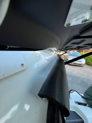

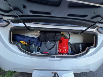

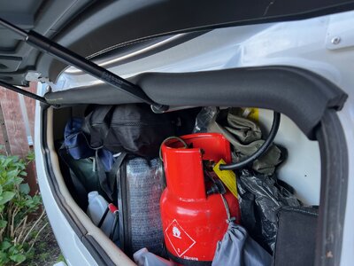

I got some Armaflex delivered and fitted that today - it's due to pour down tonight so it'll be a good test.
Hopefully this will go some way to resolving the issue. If it does not then I'll report back.

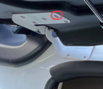

The hinge in your picture seems to be adjustable. This would bring the top of the door into the seal.
Loosen the screws and push it in, then retighten. Keeping the fingers crossed.

We put the Armaflex across the top of the locker lid and not the interior.
