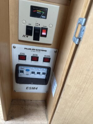

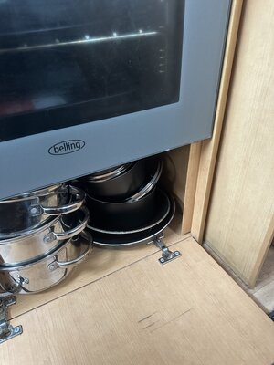

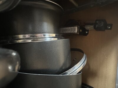

Found the fuses under the cooker in the bottom cupboard replaced a blown ten amp fuse fridge working igniter working doggy sockets working but still no pump the light on the main panel doesn’t light up either is there a reset switch?

Oh silly you, what an obvious place to put a fuse box.
If the pump is in the Aqua roll , try cleaning the contact on the end of the connection to caravan, or maybe the pump is stuck, small screwdriver in the end to just "flick it".
